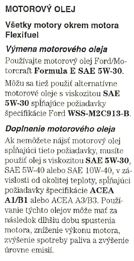

Text z manualu na FoFo II: Except vehicles with a Flexfuel engine (= mimo Flexifuel motoru, to znamena, pro nase normalni motory. (Flexifuel vehicle can be operated on unleaded petrol according to specification EN 228 or equivalent with minimum 95 octane or bio ethanol E 85. = na benzin nebo bioetanol nebo smes - to se nasich koncin asi vetsinou netyka))Roman-Jicin píše:Takže pro Ford se mají používat výhradně rychloběžné oleje ACEA A1/B1 a je v podstatě jedno jakou mají viskozitu a jestli je to polo či plná syntetika?
Use Ford/Motorcraft Formula E SAE 5W-30 engine oil. (Ten je doporucen primarne.)
Alternative engine oils with the viscosity SAE 5W-30 meeting the requirements of Ford Specification WSS-M2C913-B may also be used. (Take lze alternativne pouzit, tak proc ne?)
Vehicles with a Flexfuel engine (Pro Flexifuel ...)
Use Ford/Motorcraft Formula-S SAE 5W-40 synthetic engine oil.
Alternative engine oils with viscosity SAE 5W-40 meeting the requirements of specification ACEA A3/B3 may also be used.
Engine oil top-up (= doliti) Except vehicles with a Flexfuel engine
If you are unable to find an oil that meets this specification, you must use an oil of the (= pokud nemate spravny olej, muzete pozit nasledujici podle okolni teploty ...) viscosity SAE 5W-30, SAE 5W-40 or SAE 10W-40, according to ambient temperatures, meeting the requirements of either ACEA A1/B1 or ACEA A3/B3 specifications. Use of these oils may result in longer cranking periods, reduced engine performance, reduced fuel economy, and increased emission levels.
Tolik anglicky manual na FoFo II. A nyni se podivejme na slovensky manual na FoFo II a hle anglicky 40 sa po slovensky povie 30
Vous pouvez utiliser une autre huile moteur SAE 5W-30 tant qu'elle répond à la spécification définie par WSS-M2C913-B.
Note : Si vous utilisez votre véhicule dans des températures inférieures à -20°C, n'utilisez pas l'huile moteur SAE 10W-40.
Appoint d'huile : Si vous ne parvenez pas à trouver une huile conforme à la spécification définie par WSS-M2C913-B, vous devez utiliser de la SAE 5W-30 (de préférence), de la SAE 5W-40 (sauf véhicules à alimentation mixte) ou de la SAE 10W-40 répondant à la spécification définie par ACEA A1/B1 (de préférence) ou ACEA A3/B3. L'utilisation de ces huiles peut entraîner des périodes de démarrage plus longues, une baisse de performances du moteur, une augmentation de la consommation de carburant et du niveau des rejets polluants.
A nemecky manual pise totez:
Es kann auch ein anderes SAE 5W-30 Motoröl verwendet werden, wenn dieses der Spezifikation WSS-M2C913-B entspricht.
Beachte:Wird das Fahrzeug bei Temperaturen unter -20 °C betrieben, darf kein SAE 10W-40 Motoröl verwendet werden.
Öl nachfüllen: Ist kein Öl der Spezifikation WSS-M2C913-B verfügbar, muss SAE 5W-30 (vorzugsweise), SAE 5W-40 (außer Fahrzeuge mit bivalentem Kraftstoffbetrieb) oder SAE 10W-40 verwendet werden, dass entweder die Spezifikation ACEA A1/B1 (vorzugsweise) oder ACEA A3/B3 erfüllt. Die Verwendung dieser Öl kann zu längeren Startphasen, Leistungsverlust, erhöhtem Kraftstoffverbrauch und erhöhten Emissionswerten führen.
Tak, Romane, a ted teprve mas pravo z toho byt jelen! Ale nebud, nedelej z toho vedu. Pokud si nejsi jisty, rid se podle toho, zda olej ma specifikaci Ford WSS-M2C913-B. Pokud ji nema, neznamena to, ze je opravdu spatny. Pokud mas MOTOROVY olej 5W-30 kvalitni znacky, ktery splnuje alespon specifikaci ACEA A1/B1, tak ho pouzij.
